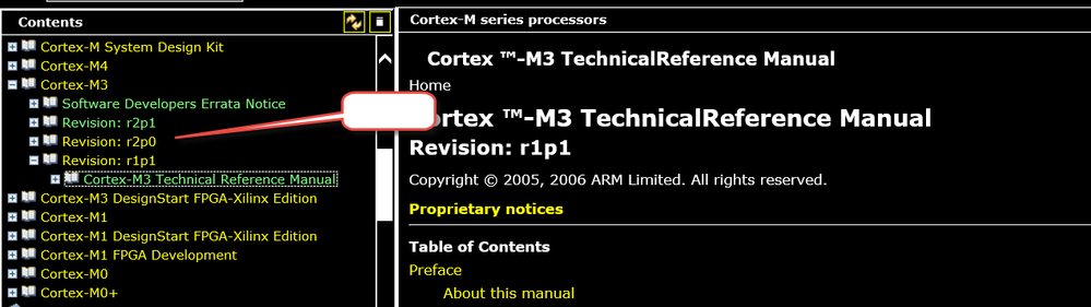

Can you please provide me the ARM Revision Number of TRM which is used for HSM Cortex-M3 within Aurix 2G family?
I couldn't find any reference within the HSM Target Spec.
4389.attach

This is referenced in the "References" section [2].
HRK
it's revision r2p0.
