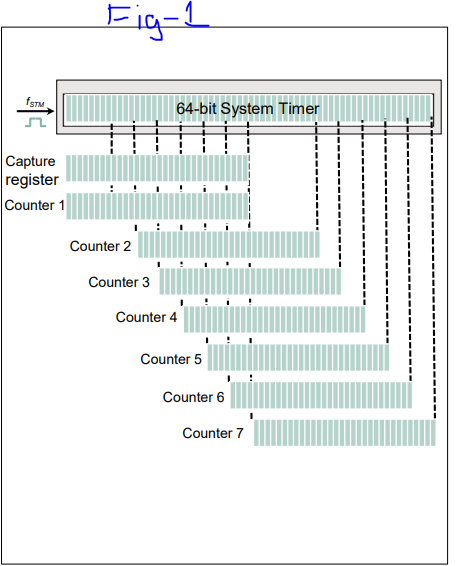

Hello All ,
Can any one please explain me how the STM(system timer logic works). i can understand it is a 64 bit timer and the value cannot be read in full so it is spitted into two registers. The interrupt generationof the tick is based on the compare and capture value of the timer.
I am not able to understand how the compare and capture register are acting producing counter at required rate(eg 1 ms). Please can you explain with an example especially the snapshots below(Fig 1 and Fig 2).
i will be really grateful to anyone providing me this explanation

Have you looked at this post?

Hello Cwunder,
Thank you very much for the link.
Please can you explain me the scope of the function IfxStm_increaseCompare(g_Stm.stmSfr, g_Stm.stmConfig.comparator, TimeConst_100ms); (IncreaseCompare).

And also from the link provided, It is a very nice description, but i am not getting How to determine the STM ticks. As it is mentioned over there,
1) To calculate the compare value you take the period you want and divide it by the tick time of the STM. How do we determine the STM tick rate as 10nsec ?
2) Now you need to remove the trailing zeros from this value which will also be the MSTART value. In this case it is 7, and now we right shift this by 7 to get 0x1312D which is the compare value. How do we determine the MSTART and MSIZE value?
Please shed some light on this including my question in the above thread.

I don't use the iLLD so I cannot comment on them.
In regards to the STM tick rate being 10nsec; if you have the system timer being clocked at 100Mhz then the resolution is 10nsec.
For a 100msec timeout, the compare is 0x1312D, MSIZE0 is 17 and MSTART0 is 7 (CMCON = 0x711)
Example code for the Hightec

hello Cwunder,
thank you very much for more detailed reply, kindly apologise for asking this question again.
i am trying to figure out how MSTART and MSIZE vlaues are set. For the above example,
For example, Compare value is 0x1312DU MSIZE is 17 and My question How and why come MSTART valuue is 7 and also left shifted to 8 bits( 7u << 😎 ?
and in Compare value 1 (0x5F5E1u), I can understand the MSIZE1 is 19 but why it is left shifted to 16(19u << 16u).. How do you get MSTART1 value as 8 and leftshifted to 24 bits.(8u<<24u).
Basically my question is How the MSIZE and MSTART values are arrived and that with left shift operator.?

Here is detailed explanation for 50msec timeout. Hopefully you can figure it out for another timeout.

Thank you C wonder, it is indeed very useful to understand with schematics.
