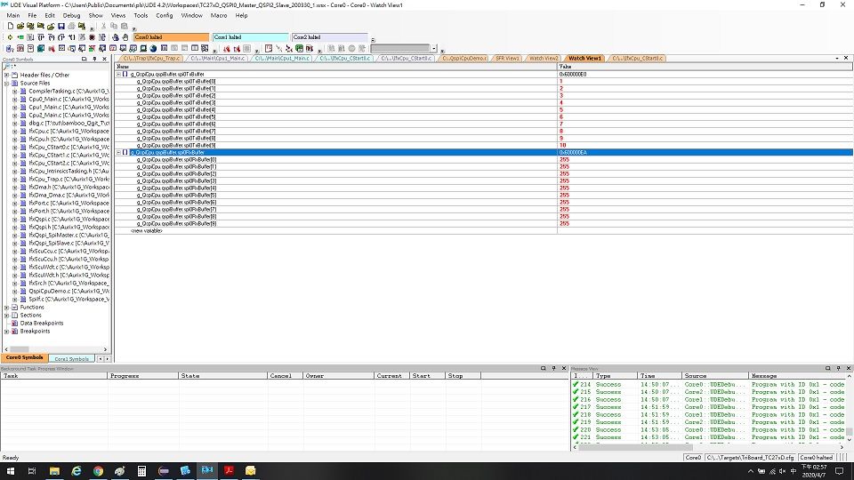

I am also using TC277 Triboard and the QspiCpuDemo of iLLD demo code, but QSPI2 Slave can not work properly.
I also used the Logical Analyzer to check the transmission, I could count the SCLK and MTSR, The QSPI0 Master transmits data correctly, but the MRST only show the 0x00 and 0xff periodically as the attached picture shows.

Hi VincentWan,
Thanks for your reply.
I connected the QSPI0 & QSPI2 port together via the extension board on the TC277 triboard as the picture show, and I removed the R302 and the EEPROM from the TC277 triboard too.
When I use the debugger, the interrupts come in as the pictures showed.
The SFR View 1 showed the [Slave Transmit and Receive] in QSPI2_GLOBALCON after ISR_qspi2_Rx interrupt happed.
But the spi0RxBuffer is still received 0xff (255), (no 0x00 (0) after I removed the EEPROM), and spi2RxBuff is still received 0x00 (0).
Do you have any idea for this issue?

Hello deepakseshan1,
did you try using the example SPI_CPU_1? It has been reworked on the last release, together with its tutorial: SPI_CPU_1 tutorial
It has been developed for the KIT_AURIX_TC297_TFT board but it can be easily ported to any other kit.
hope it helps,

Hi teoBits,
Very thanks for your reply.
The example code could run on the TC277 Triboard properly.
This information is really helpful.
