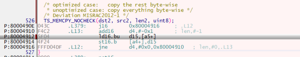

Hello Community,
I ran into a very weird issue.
I have authorized all sections to run/read/write in my Memory Protection Set, but a certain line still causes Trap 1 (TIN 2, meaning read protection) 😞
I would very appreciate if someone could help me take a look at this, I'll add screenshots from my debugger:
Line the causes the Trap Jump

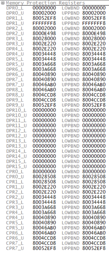

And Here is the Memory Protection Set With upper and lower bounds:
*PROTEN is enabled and PRS is Set0

But isn't A5=8000E4B7 before the trap? That looks outside of your ranges. Odd that DEADD is something else though.

DPR2 section is defined only until 0x8000E498 therefore 0x8000E4B7 is out of this range and not defined in another range. This result in the protection trap. After change this there will be occur an alignment trap if the address is not corrected to a 16 bit aligned address.
