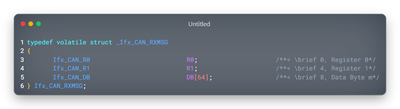

I wonder if everyone has my same problem or has  resolve it. I implemented on TC375 a CAN communication - I set the can module on TC375 as a receiver one. My aim is to obtain, for every received message, the timestamp of the message itself.
thought to associeted, every time the interrupt routine of received message was triggered, a subroutine which use STM0_TIM0 register, but i have some problems, the number obtained it's not easily understandable.
There are other ways to extract time stamp of messages on CAN bus communication for TC375?
A specific library for example or similar?

On start of frame reception / transmission the counter value is captured and stored into the timestamp section
of an Rx Buffer / Rx FIFO (RXTS[15:0]) or Tx Event FIFO (TXTS[15:0]) element.
You can check the RX Buffer for timestamp. Do you have any question on this?

Please check below struct for R1.
dw
1000 replies posted 250 solutions authored 100 likes received
IFX_INLINE uint32 IfxCan_Node_getDataLengthCode(Ifx_CAN_RXMSG *rxBufferElement)
    return (IfxCan_DataLengthCode)rxBufferElement->R1.B.DLC;
Above call is for your reference. You should modify as your request.

Hi Sara, Yes you can do this, please note that DLC is not timestamp, you should modify the code.

So maybe I didn't get which available variable the time information was stored?
Referring to my "pseudo code" : time_stamp will be equal to what?
