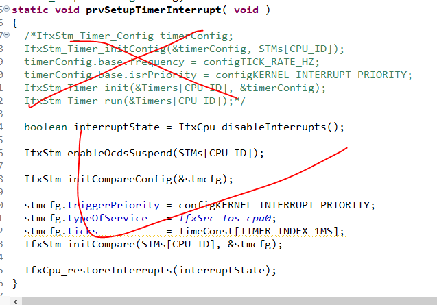

Aug 26, 2021
06:47 PM
Aug 26, 2021
06:47 PM
For FreeRTOS:
