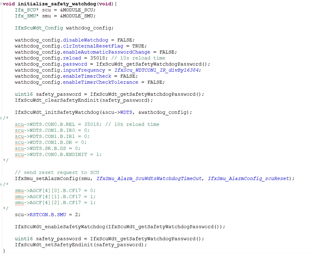

Recently I got in troubles by trying to use safety watchdog in combination with SMU on TC222

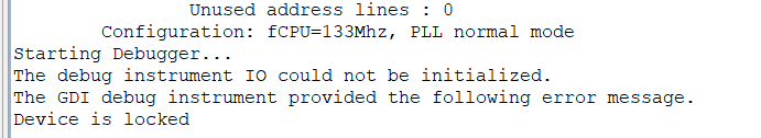

The problem is that when trying to initialize safety watchdog, uC enters some kind of lock mode (tasking_log.png) and I am unable to program the uC afterwards. Memtool can only erase the memory but I can happen only once, after that im unable to reprogram the uC
I was using following code to get the safety watchdog running with 10s of time out time that would generate alarm to SMU resulting in system reset:
For now I have two boards that I cannot connect to, is there a possibility to unlock theses devices?
Is it possible that this code may cause such behaviour?
Is it a correct way to initialize and enable safety watchdog with SMU?

Maybe the device is in a wrong boot mode. What is the state of the reset LED? They are always on or off? When you connect via Memtool the LED is on for a short time?

You are right. I don't had attention to this fact. Can you check with DAS Device Scanner if there is any connection? Open DAS Device Scanner, select the device by Start Client. You will get an error message, cancel or select Reset Device. Which answer you get here always Device Locked or Device in Reset?
