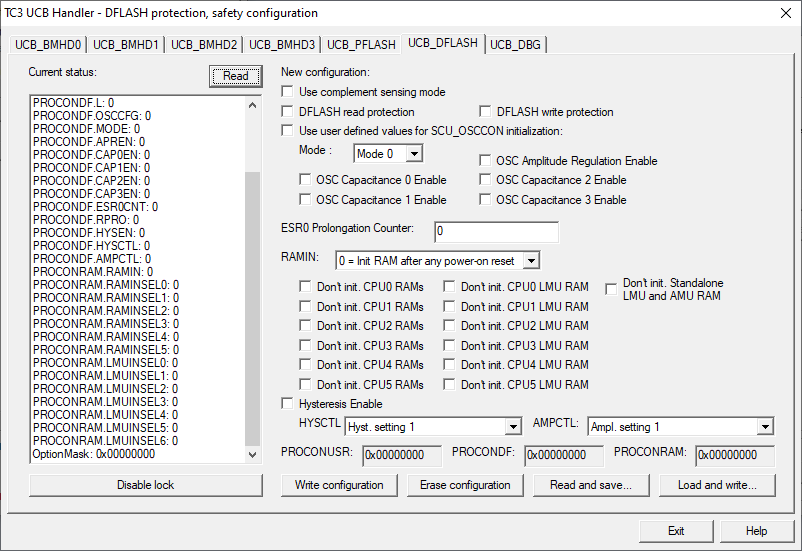

I tried to flash my firmware file onto a TC39B device with memtool over BSL. I got the same error every time after the flashing has been started, and it fails exactly at the same address.
Is there something I forget to configure before flashing that could cause this error?

Sure, I've tried erasing the entire flash first, then flashing the device, but I got the same.
According to the datasheet this memory address is located in the Program Flash 1 (PF1). Is it possible that this is sector is protected?

You could find out if protection has been set by looking at the HP_PROCONPiP registers - this will tell you whether any was set.
When doing the erase, did you do just an erase, or an erase-verify (i.e. erase verify logical sector range)?

I've checked with the memtool, in the UCB_PFLASH tab all the PROCONP register have 0x0000000 values for PFLASH0-5.
I did not find an erase-verify option in memtool, however I ran a device empty test. All of the sectors shown empty there.
I've removed all sectors which are not located in PFLASH0, and this time flashing was done successfully. Is it possible that I can only program PFLASH0 with memtool over serial BootStrapLoader(BSL)?

You could also check the one-time programmable PROCONOTP/WOP - if they are set, then flashing won't work after the first one.

Where can I find the PROCONOTP/WOP in memtool?
I could not find anything that could cause this flashing problem. It seems to me that basically everything is set to default.
Here are all my UCB setting read with memtool:

The OTP is set in UCB_OTPx, which starts at 0xAF40_4000, but this doesn't seem to be available to you in this tool, which I am not familiar with. Is there any other information anywhere apart from "failed" - any log messages etc?

This is the only log I can get from memtool. Unfortunatelly does not contain more information about the cause of the failure.

Jun 19, 2020
05:41 AM
Jun 19, 2020
05:41 AM
The address of failure is in PFlash1, and assuming that you are reading back in sequence, this mean that the read back from PFlash0 was correct and worked. The address which has failed is not at an obvious boundary, so it wouldn't be protection. It would be good to know if there were any errors reported when performing the read. Forgive my complete lack of knowledge over what you are running and the tools, but while running the memtool are you able to run register reads at all? It would be good to know what error the CPU was reporting when performing the read, and whether any ECC errors are being reported by the flash when being read.
