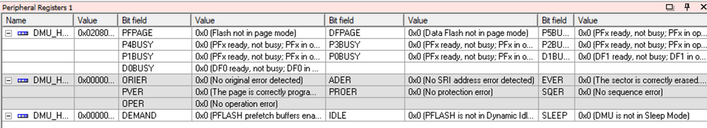

Concerning an exception I would need to know what Trap you are entering and the relative details.
The code I posted does run without issues in my setup for a TC389. I am writing to PFlash 0
flashStatus = Flash_WriteProgPage((uint64 *)0xA0038000, (uint64 *)&testArray[0], IfxFlash_FlashType_P0);
Here is the screenshot from the debugger

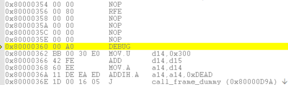

I do not know which trap , but trap table starts at:
0x80000300
Stack of traps:
0x80000300
first_trap_table:
0x80000300 00 A0 DEBUG
0x80000302 BB 00 00 E0 MOV.U d14,0x0
0x80000306 42 FE ADD d14,d15
0x80000308 60 EE MOV.A a14,d14
0x8000030A 11 DE EA ED ADDIH.A a14,a14,0xDEAD
0x8000030E 1D 00 EC 05 J call_frame_dummy (0x80000EE6)
0x80000312 3C 00 J 0x80000312
0x80000314 00 00 NOP
0x80000316 00 80 RFE
0x80000318 00 00 NOP
0x8000031A 00 00 NOP
0x8000031C 00 00 NOP
0x8000031E 00 00 NOP
0x80000320 00 A0 DEBUG
0x80000322 BB 00 10 E0 MOV.U d14,0x100
0x80000326 42 FE ADD d14,d15
0x80000328 60 EE MOV.A a14,d14
0x8000032A 11 DE EA ED ADDIH.A a14,a14,0xDEAD
0x8000032E 1D 00 DC 05 J call_frame_dummy (0x80000EE6)
0x80000332 3C 00 J 0x80000332
0x80000334 00 00 NOP
0x80000336 00 80 RFE
0x80000338 00 00 NOP
0x8000033A 00 00 NOP
0x8000033C 00 00 NOP
0x8000033E 00 00 NOP
0x80000340 00 A0 DEBUG
0x80000342 BB 00 20 E0 MOV.U d14,0x200
0x80000346 42 FE ADD d14,d15
0x80000348 60 EE MOV.A a14,d14
0x8000034A 11 DE EA ED ADDIH.A a14,a14,0xDEAD
0x8000034E 1D 00 CC 05 J call_frame_dummy (0x80000EE6)
0x80000352 3C 00 J 0x80000352
0x80000354 00 00 NOP
0x80000356 00 80 RFE
0x80000358 00 00 NOP
0x8000035A 00 00 NOP
0x8000035C 00 00 NOP
0x8000035E 00 00 NOP
0x80000360 00 A0 DEBUG
0x80000362 BB 00 30 E0 MOV.U d14,0x300
0x80000366 42 FE ADD d14,d15
0x80000368 60 EE MOV.A a14,d14
0x8000036A 11 DE EA ED ADDIH.A a14,a14,0xDEAD
0x8000036E 1D 00 BC 05 J call_frame_dummy (0x80000EE6)
0x80000372 3C 00 J 0x80000372
0x80000374 00 00 NOP
0x80000376 00 80 RFE
0x80000378 00 00 NOP
0x8000037A 00 00 NOP
0x8000037C 00 00 NOP
0x8000037E 00 00 NOP
0x80000380 00 A0 DEBUG
0x80000382 BB 00 40 E0 MOV.U d14,0x400
0x80000386 42 FE ADD
Stack of traps:

UC_wrangler wrote:
Note that the AURIX does not support writing to PFLASH while anything is reading from the same PFLASH bank - including the CPU. If you want to write to PFLASH0, that means you either need to execute from some other PFLASH bank, or from RAM.
So how come this works in step-by-step debug?
moreover, I use flash bank pf0 in the firs bank but write to the second, i.e 0xA0004000
