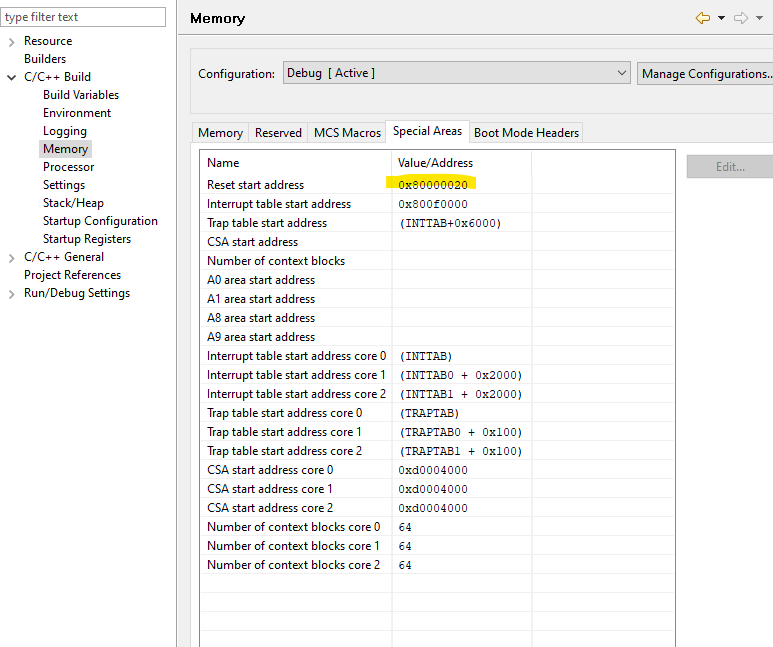

@MoD: ERS0 is always low, no transition is present at power up. But as above I can connect with the Memtool and the UCB seems correct (at least what we could see here) so I don't htink is broken or UCB corrupted.
@Vincent. Why is not correct? In my code this is the starting address. Also other board have the same starting address and are working properly.

I've another idea.. I've seen is possible to download a SW with the memtool but the address allowed are only Axxxxxxx. My code runs on 8xxxxx. I can move my code to Axxxx and download the code via the memtool but then the starting address into the UCB will be wrong. Is is feaseable to change it via the memtool (I've never done it).
Only change the value and press write or some other steps are necessary (checksum, UCB copy update, password to enable writing)

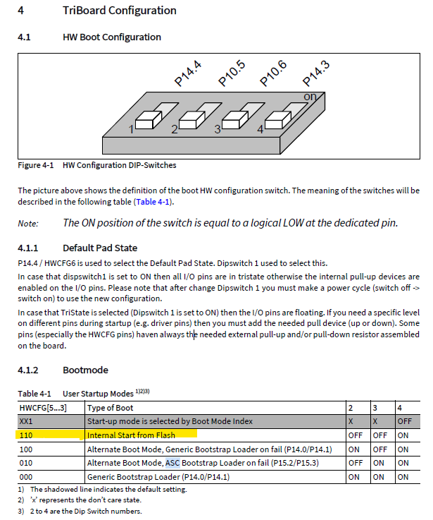

FD_aurix
Level 5
Level 5
100 sign-ins 100 replies posted 5 solutions authored
Yes sure. I'm actually working on a Triboard demoboard so I've a DIP switch where I can easly change the HWCFG pins configuration.
5467.attach
The connection is done with the onboard circuit present on the board. I think is the same HW of the miniwiggler.
User9635
Level 4
Level 4
50 replies posted 50 questions asked 25 replies posted
5467.attach
So, to which pins on TriBoard you are connecting the Host PC interface using miniwiggler external USB Adapter so that MemTool can perform initial BSL related RAM download?
FD_aurix
Level 5
Level 5
PC is connected to the Triboard USB. Then there is a build in debug/program interface on the Triboard (I think is the same HW more or less of the miniwiggler) that is connected to the uC. You can check the triboard schematics for the wiring. Then I connect via the Memtool in ASC/BSL mode (DAP mode do not work in my case till the uC was in "locked" condition).
