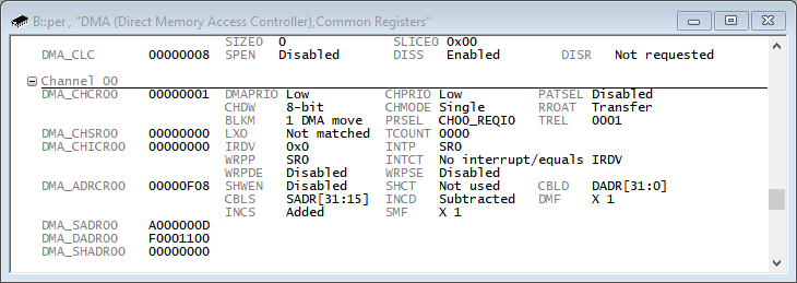

Conditions:
PFLASH0_FSR: bit RPROIN is 1
bit RPRODIS = 0 (meaning read protection is installed and enabled)
FLASH_FCON; bit RPA is 1 (meaning protection is active),
bit DCF is 1 (Disable Code Fetch from Flash Memory, meaning code fetch is not allowed)
bit DDFDBG is 1 (Disable Data Fetch from Debug System, meaning data fetch is not allowed)
bit DDFDMA is 0 (Disable Data Fetch from DMA controller, meaning data fetch is allowed)
bit DDFPCP is 0 (Disable Data Fetch from PCP, meaning data fetch is allowed)
I have tried moving one byte from both PFLASH and SPRAM to a destination in SPRAM or the GPIO PORT0, the transfer appears to have completed however the destination remains unchanged.
I have the source address set for auto-increment and after the transfer completes the source address register has incremented.
Here is my code

The TC1766 is a legacy device and not recommend for new designs.
You have the source pointer set the SPRAM and the destination is DMA_target which no clue where you have this.
In addition you have the read protection on, I would suggest to debug the code with the Flash read protection off.
I have a TC1767 TriBoard with a setup to match most of your code. There are LEDs on P5 which are configured as output. The DMA channel 0 is set up to transfer Flash bytes to P5_OUT. When running the code you will see the LEDs updated by the bytes being read from the PFlash.
volatile unsigned int cnt;
void DMA_ChannelInit(void)
unlock_wdtcon();
DMA_ME0AENR.U = 0xFFFFFFFF; // Access enable register, enable everything
DMA_ME0ARR.U = 0x00000000; // Access range register
lock_wdtcon();
// Configuration of DMA Channel 00:
DMA_CHCR00_type chcr00 = {
.B.DMAPRIO = 0, // DMA Priority : Low
.B.CHPRIO = 0, // Channel Priority : low
.B.PATSEL = 0, // Pattern select disabled
.B.CHDW = 0, // Channel Data Width : 8-bit
.B.CHMODE = 0, // Channel OPeration Mode : Single Mode
.B.RROAT = 0, // Reset Request Only After Transaction
.B.BLKM = 0, // One DMA transfer has 1 DMA move
.B.PRSEL = 0, // Peripheral Request Select is not used
.B.TREL = 1, // number of DMA transfers for DMA transaction
DMA_CHCR00.U = chcr00.U;
DMA_SADR00.U = 0xA0000000; // source address is the PFlash
DMA_DADR00.U = (uint32) &P5_OUT.U; // destination address P5_OUT
DMA_ADRCR00_type adrcr00 = {
.B.SMF = 0, // Address offset is 1 x CHCR0x.CHDW
.B.INCS = 1, // Address offset will be added
.B.DMF = 0, // 000B Address offset is 1 x CHDW
.B.INCD = 0, // Address offset will be subtracted
.B.CBLS = 15, // Source address SADR[31:15] is not updated
.B.CBLD = 0, // Destination address DADR[31:0] is not updated
.B.SHCT = 0, // Shadow address register not used
.B.SHWEN = 0, // Shadow Address Register Write Enable
DMA_ADRCR00.U = adrcr00.U;
/* entry point from cstart */
void main(void)
// LEDs on P5[7:0]
P5_IOCR0.U = 0x80808080;
P5_IOCR4.U = 0x80808080;
// setup the DMA for Channel 0
DMA_ChannelInit();
while (1) {
for (cnt = 0x500000; cnt--;)
// trigger transfer
DMA_STREQ.U = 1;
