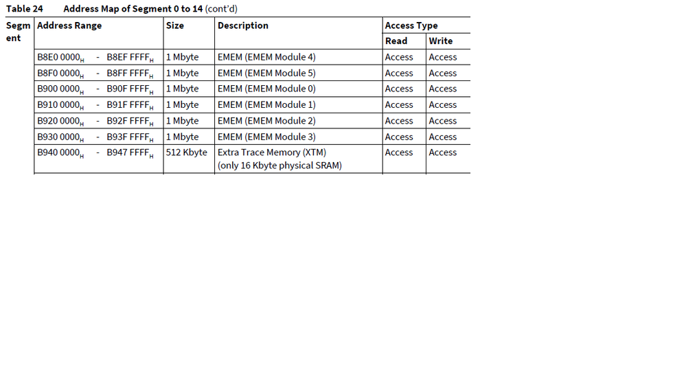

We are currently working on the TC397 evaluation kit for our project.
With reference to the attached image from the manual (AURIXTC3XX_um_part1_v2.0.pdf -->Table 24 Address Map of Segment 0 to 14 (cont’d)),
we are trying to access the total 6MB of EMEM (Extension Memory).
5199.attach
We were able to access 4MB(Modules 0 to 3) of it but the remaining 2MB of it is still not accessible(Modules 4 & 5)
Could you please provide a sample code snippet/ throw some light on how to configure the whole 6MB of EMEM as RAM?
We would like to use EMEM as Random Access Memory (RAM) in our project. Hence, request to provide some inputs.

The ADAS device (SAK-TC397QA-160F300S) and extended device (SAK-TC397XX-256F300S) have 4 MB of EMEM, per the datasheet addendum (TC39x_Data_Sheet_Addendum_v1.6.pdf).
