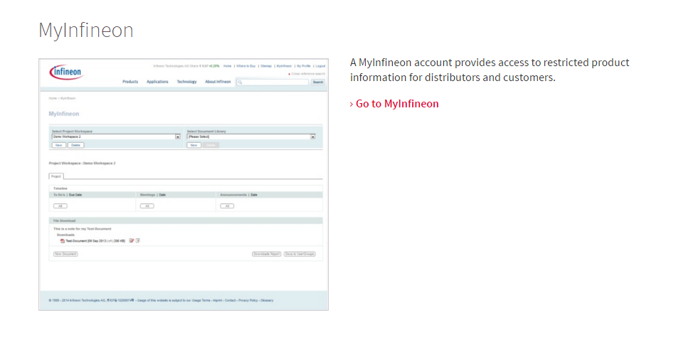

There should be something wrong with my account since I can't just find that "Library Root". The closest place I see that could lead me there is when I go to this address:
https://workspace.infineon.com/cms/en/login-overview/
And there I can see the following:
But as soon as I click on "Go to MyInfineon" I'm redirected to the main website.
Have anyone experienced something like this?
Thanks!!
Thanks!!
By the looks of it, you have not signed up yet. Note that when you click the "Go to MyInfineon" link, you are redirected to this page:
To be able to authenticate here you must actually first signup. Follow the little FAQ link, also depicted on the snapshot. The first question of the FAQ explains how you can create your MyInfineon account.
