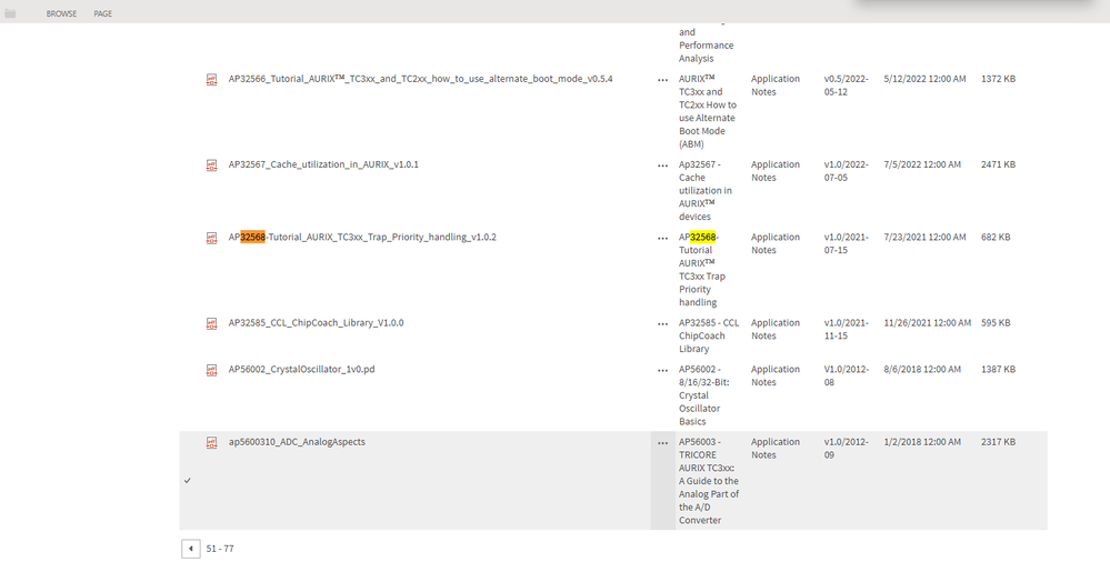

one question: I can't find the application note (AP32568) could you send it to me? this link can't find it.
BR
Hi @kelejichi ,
Thanks for your reply.
Actually, please follow the below figure to download it.
BR,
