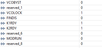

I changed all the register to the values you have provided, it kinda worked but i found another problem, multican module stopped working properly, no frames are sent on multican, only this is visible on scope:
After changing all the register using your values, my fpllVCO is equal 800Mhz and pll 133.33
pllstat is here:
After digging into user manual and ILLD, i found out, that multican freq for fCLC is fSPB
pllstat is here:
pllstat is here:
pllstat is here:
