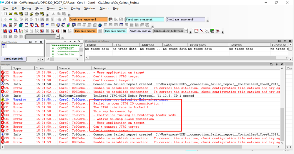

I have made a mistake to run a funcion at the TC297TF(as below, function name: flash_ucb_hsmcotp(1) ).
then i try to use UDE-Debuger reconnect the chip, it works no never. These codes maybe erased and rewrited the flash at 0xAF100800. I dont know how to solve it or reset the chip. Who can help me? THANKS!!!

I did not check the content you programmed in detail but most likely you did enable the Hardware Security Module without having valid code for it in the Flash. This leads to a situation where protection including Debug interface protection is enabled.
This means you will never be able to connect to this chip again unless you have a separate SW flashed in the Chip beforehand that is able to unlock upon a command from any diagnosis interface. (Which I guess is not the case with your current setup).
For trials with UCB programming and HSM especially I recommend to use an ECU with a socket and a few spare samples. Also please read the UCB section of the user manual very carefully since it is quite easy to accidentally enable protections and lock the debug interface.
