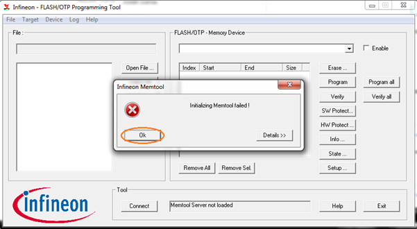

For Locking/ Unlocking the debug interface Infineon Memtool can be used.
Please follow the below steps
Device Setup
1.Power on the Aurix Development Kit.
2.Connect the Aurix device with system (i.e. PC) through Micro USB Connector.
3.Open Infineon Memtool.
There will be a pop-up message “Initializing Memtool failed”.
Click Ok.
Status : Not initialized
Now click On Target-> Change
Following message will pop-up.
Click OK.
Click on Default to use predefined configuration files
Device Setup
Click Ok.
Click OK.
Feb 11, 2019
04:18 AM
Feb 11, 2019
04:18 AM

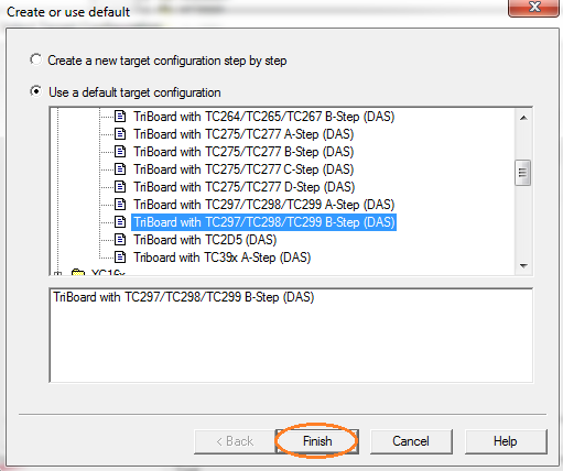

Configuration list will pop up, select the appropriate configuration.
We will select,
TriCore Aurix -> Starter Kits (DAS) -> TriBoard with TC297/TC298/TC299 B-Step (DAS)
You may select your respective device
Click Finish.
Now save the configuration at a desired location.
Click OK.
Check the status,
It will show Target not connected.
Now Click on "Connect" to connect the target.
Once the target is connected successfully the status will be changed to “Ready for Memtool Command”
We will select,
Click Finish.
Click OK.
Check the status,
