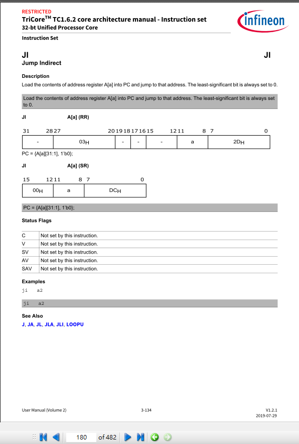

1. click .inttab_tc0_004@184 on the left window on UDE, it will shows disassembly coe, see attach file "0-inttab_tc0_004.png"
2. The code are comiled to rsic instructions and they are placed from address 0x802F E080, which maps to IVT TAB priority = 4
3. When interrupt happens, it jump to address 0x802F E080, from here four instructions will be fetched and executed, they are
(1). SLVCX(Save Lower Context)
(2). Move High 16-bit address 0x8000 to cpu general purpose register A14, or "MOVH.A a14, 0x8000"
(3). Load Effective Address(LEA), use Base + Long Offset Addressing Mode, or "LEA a14, [a14]0x2522"
(4). Jump Indirect(JI) to the effective address got from step(3), or 0x8000 2522, which is the address of ISR "ISR_Asc_0_rx(void) in file "IVTTAB_and_ISR_rx_tx_ex.png"
for more details, see attach files, 01-SLVCX.png, 02-MOVH.A.png, 03-LEA.png and 04-JI.png
