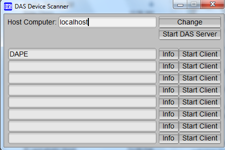

I am trying to use memtool for Aurix TC29x controller. I have connected target with miniwiggler. When I open DAS device scanner I see that device is detected as "DAPE".
When I open memtool I see following error.
Can you please help me in resolving this?
