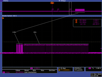

To get the max data rate, I wanted to set max DAP clock frequency and therefore, I set it to 30Mhz but somehow, I was not able to see any change in cycle time. Measuring the DAP clock on Pin No 4, I come to know that it's only 3Mhz instead of 30Mhz. Current clock value on DAS interface still shows 30Mhz!!!
Here is the snapshot of the DSO showing 3Mhz clock instead of 30Mhz. Clock on C4 is the Zoom out version of the clock. Z4 is the zoom in version of the C4. (1/Delta x) is 3.13 Mhz. I have also attached higher resolution image as a ZIP for the reference.

Hi D1,
Currently OneEye check the MCD connection  before each transaction over the DAP interface. This check is the one that temporary set the clock to the 3MHz as below showed.
If you measured after that, then the communication should be 30MHz. Can you confirm?

Our engineer investigated found 3MHz and 30MHz freq both in the communication. Attached is the waveform of scope.
Could you please check if you have 30MHz waveform in the communication?

Hi dw,
I have few queries now,
  1. Were you changing the frequency run time, I think once you set the frequency using DAS, it should be same frequency for all communication.  Or did you combine 2 different plots?
  2. Will you be able to provide protocol level document for DAP?
  3. I was setting 30Mhz in OneEye and I captured below log when I tried to connect. It says it tried to connect 30Mhz but set it to 3Mhz. I need to know on what reasons it reconfigures itself to 3Mhz?

Trying to connect at frequency 3e+08
MCD connected at frequency 3e+07

Hi D1,
