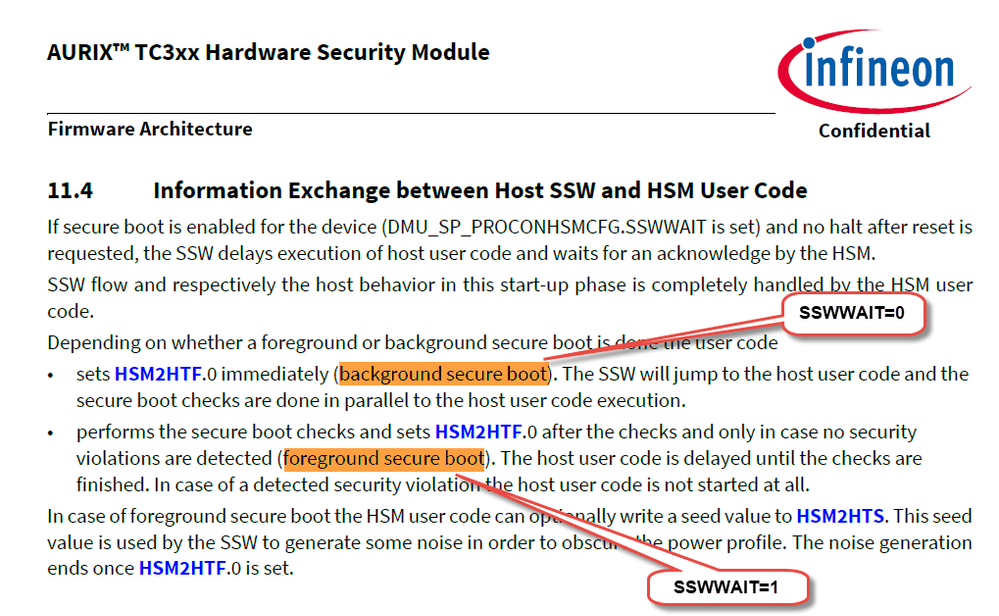

Hello Support,
Please confirm if foreground secure boot means SSWWAIT=1
and
background secure boot means SSWWAIT=0
as shown below:
4438.attach
Best Regards
May i get this User Manual link?
Harvey
SSWWAIT is not related to this topic.
SSWWAIT is configuration for secure boot operation.
Secure boot means that check Tricore code integrity from HSM. Not HSM code.
Generally, HSM code is not checked because we assume that HSM code is already stored in secured Flash area
So,
If SSWWAIT set "1", Tricore SSW will jump after finish secure boot operation even though Tricore SSW sequence finish (Foreground secure boot)
If SSWWAIT set "0", Tricore SSW will operate in parallel secure boot operation on HSM (Background secure boot)
