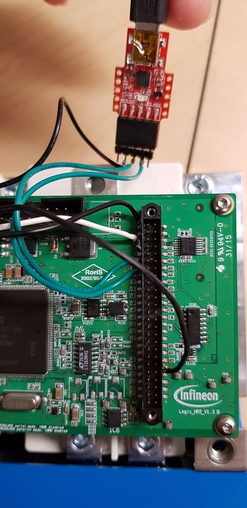

Hello all,
A little background - I am an electrical engineering intern in an electric motorbike company.
I was given an Infineon Hybrid-Kit for HybridPACK 2 Enhanced power module, and I am trying to 'communicate' with the microprocessor TC1767 on board.
My questions are:
-What software can I use to programme the microprocessor and through what protocol/cable?
-Also, what other extra boards/pheripherals do I need?
I am really confused here, as I have never done any system level design/integration before.
Any help is appreciated.
Thank you very much for your kind assistance.

You can find all on Infineon.com (search works fine)
Links:
Hybrid kit 2.0 version 1.3 (50 pin connector)
https://www.infineon.com/dgdl/Infineon-AN2014_08_Hybrid_Kit_for_HybridPACK2-AN-V02_04-en.pdf?fileId=...
This is the info site for Tricore 1767
Here you can find documentation and Video about the main processor on the logic board.
https://www.infineon.com/cms/en/product/microcontroller/32-bit-tricore-microcontroller/audo-family/t...
And this the Tools section, here you can download the Software if it is not on your CD provided with the Hybrid kit.

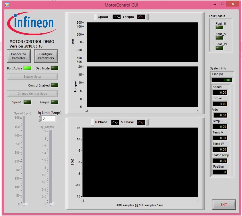

With the Hybrid kit comes a CD which normally includes 3 main Components for getting known to the board and tools:
1) MotorControl.exe (for Windows XP or older)
This communicates through the old (9-pin) serial port of your PC (RS232 )with the 34-Pin / 50-Pin interface of your board (pin count is depending on Version)
Here is an example of connector:
https://www.ehitex.de/application-kits/infineon/2488/external-connector-cable-for-hybrid-kit
You will need to buy it (on eHitex.de for example) or make it yourself. if you have no 9-pin Serial interface (RS232) you need also to buy a RS232 to USB-converter.
The MotorControl.exe Software communicates with an onboard existing Demo - program (if existent) which can drive a small Motor if connected.
2) Dave Bench Tricore1767Dip-files and Demo-code. This are files which the Dave-Eclipse-Studio from Infineon uses to configurate the TriCore-processor.
3) Some basic info and doc describing the Hybrid kit
What you need to get when programming your own code is:
1) Software Developer Platform for Developing and testing the Demo-Code.
I recommend the DaveBench - Platform together with the Dave-Eclipse-Studio from Infineon.
(the DaveBench uses the dip-files to generate c++ code from preconfiguration, which can be used in the Dave Eclipse Studio)
You can download the Dave-Studio at the above links together with the Hightec-Tool - chain which helps compiling and linking the code to a hexfile.

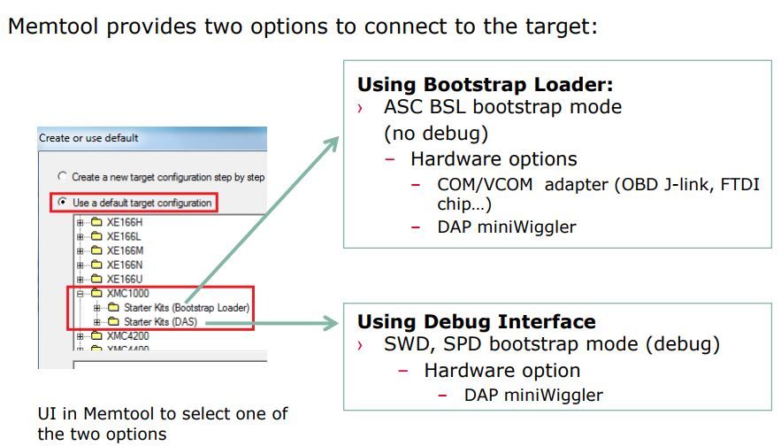

2) A connector to the board to download the hexfile to the tricore-processor
Two possibilities:
a) Going Serial through the 34-/50 pin connector, this is the same connector as used for the MotorControl-Software above
(https://www.ehitex.de/application-kits/infineon/2488/external-connector-cable-for-hybrid-kit).
After that you have a lot of painful possibilities to download the hex files with the flash-tools / bootstrapper
https://www.infineon.com/dgdl/AP3213211_TriCore_AUDO_F_Bootloader.pdf?fileId=db3a30431d8a6b3c011d960...
I would not use this interface for continuous programming, only for external communication like with the MotorControl.exe Software on PC or other devices, external CAN-bus etc)
b) Going through the JTAG 16 pin X3OCD-Interface
This is the way to go if you are developing your own code for the Tricore and you want to download often to test it on the Hybrid Kit Board
You can use the DAP-miniwiggler (Dave-Studio has excellent DAP-support) through USB-interface
https://www.ehitex.de/zubehoer/2276/dap-miniwiggler (be sure to buy the one with the 16 pin X3OCD-Interface-connection)
3) To test the exaamples provided with the Kit use a motor with encoder/Hallsensor/GMR for a drive application
see https://www.youtube.com/watch?v=Sw_kEm-3H7Y
Best regards, Gunnar

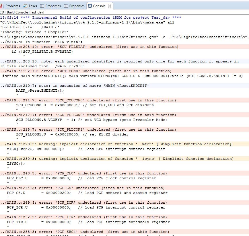

Hi Gunnar,
Thank you very much for being so generous with your knowledge and expertise.
From this website as given by you, https://www.infineon.com/cms/en/product/microcontroller/32-bit-tricore-microcontroller/audo-family/t..., I don't actually understand the various tools & software.
My knowledge is pretty limited - I am an undergraduate (year 3) intern. As such, are there any materials that gives me an overview of the various tools & software?
I have downloaded the Dave-Eclipse-Studio, which I believe is an IDE for writing codes to the TC1767 uP. However, I am unable to understand what the DaveBench Tricore1767 Dip-files and tools are used for. It seems to be able to generate .dav files which I have no idea to what the purpose is.
Also, I do not see any demo codes which I can try out.
Quote from you: "2) Dave Bench Tricore1767Dip-files and Demo-code. This are files which the Dave-Eclipse-Studio from Infineon uses to configurate the TriCore-processor."
When you say configure, do you mean configuration at the application or firmware level of the uP?
I am sorry for asking really low-level (dumb) questions as my knowledge is seriously very limited.
I have no idea how to piece the pieces of this puzzle together - I do not know how to connect the dots from software to firmware to physical connections and protocols/standards.
Please advise me on any materials which I can read to understand more about the whole embedded systems.

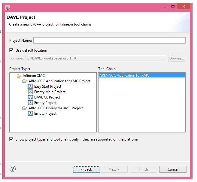

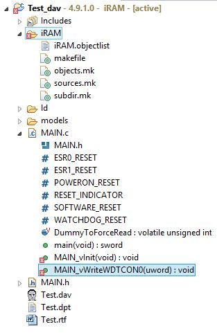

There are two tools the Dave (Bench) Visual configurator and the Dave Eclipse Studio
(might have changed in Dave version 3 but we will not be using that, we will use the version 2 which is at the Tricore site).
The Dave Bench is a visual configuration of the Microcontroller-Firmware settings which means that it generates code from your settings that is used for the Studio.
The dip-file is just a module for the Dave (Bench) that makes it possible to see the TC1767 option visually for configuration.
The .dav file which is generated (automatically) is just for the Dave (Bench) to remember the configuration status.
The most important thing for you is to let the Dave (Bench) generate the c/c++ files and headers for your project, choose the Hightec-compiler option.
You start by using the Dave (Bench) version 2 which has the Tricore support.
Download is at:
https://www.infineon.com/cms/en/product/microcontroller/development-tools-software-and-kits/dave-ver...
Edit: The correct Dave (Bench) .exe (or setup.exe) should be on your Hybrid Pack CD together with the "correct" Dipfile use this if possible as this will support your correct TC1767 (v.1.3. most likely)
After downloading/finding it run setup.exe or open Dave.exe directly if it exists (Just the Dave (Bench) not the Dave Eclipse Studio)
If you see an option for TC1767 in the Dave Bench then the Dip-file is already included (Note: It might still differ from the dip-file which came with the Hybrid kit, but lets wait there)
Start following this Video (nr. 7 !) which generates a config file for the Tricore Starter-Kit
https://www.infineon.com/cms/en/product/microcontroller/32-bit-tricore-microcontroller/?redirId=5459....
Do the same steps and generate the c++ files.
Then open your Dave Eclipse Studio (which includes the Hightec toolchain i hope) and compile the code.
I would recommend for you to buy the Tricore-Starter Kit (or any other Starter kit) just to get familiar with the process, especially if you have no experience.
The kit includes a board which has the DAP-miniwiggler (USB-connection) integrated, meaning you can directly communicate and send code through USB-interface.
Important: For the Tricore stuff, use a PC with older version of Windows if possible (Windows 7 is perfect)
Also use Dave (Bench) 2 and all the tools recommended at the Tricore page at Infenion I pointed you to for code generation.
Good luck.

Hi Gunnar,
Yes, I have the CD. However, there is no software or .dip file on it.
As such, I have followed your guidance to download the DaveBench Legacy 2 and .dip files.
I am able to generate the C/C++ codes to be imported to the Dave-Eclipse-Studio.
However, I am stuck at this stage as Dave-Eclipse-Studio is unable to import in the C files.
Also, I could not find the kit (hybridkit) in the selection as attached. Or is there a way to create a general project?
Thank you.

Ok some progress as you have now the c++ files. The Dave Eclipse Studio Project you are creating is however a XMC project which is based on the ARM Cortex and not the Tricore.
You need to make a empty or easy Tricore Project which is for Tricore 1767. After that you would add your generated files. So either you have a wrong Dave Eclipse Version or the Tricore Project option is missing?
Can you create other Project types than XMC?

Hi Gunnar,
The version I have is Dave-3.1.10. It doesn't have any options for Tricore project. Is it the wrong version?
Also, I am currently trying to flash a hex programme onto the board. There are 2 options:
Can you explain the 2 options?
Thank you very much.

Hi do you have a connection to the hybrid kit board or is it another board you are connected too?
I looked closer at the CD content and you are right it does not have the Dave. So you needed to download it
(I have probably done the same 5 years ago).
The CD has two .exe files one is a MotorControl.exe gui to communicate with the existing(!) program running on the Board.
The other will extract the code and hexfiles for the board.
The hexfile which is on the board is probably the same but do not count on it. So BEFORE flashing try to establish a connection with the board through the 50 pin connector.
It will not work with the XMC interface you are using so you need another (older?) version of Dave Eclipse Studio or a plugin in the new which supports TriCore 1767.
I will take a look at that and let you know.
EDIT: Infineon Dave Eclipse Studo does no support Tricore-devolpment (only code generation with Dave Bench)
You need a third party provider Hightec or Tasking for example.
Hightec offers a free Evaluation version with the Tricore starter kit seems it can be downloaded too:
1)http://free-entry-toolchain.hightec-rt.com/getting_started.pdf
Edit: This seems the newest version for the free Hightech-Toolchan
http://free-entry-toolchain.hightec-rt.com/ This works to get automatic download and licence in 2 -steps (registration and download)
2) Edit: This seems also to be a link for it (?)
http://www.hightec-rt.com/en/downloads/evaluation-version/21-tricore-aurix-development-platform-1/fi...
After registration I need manually to activate and get the licence-key
(Two small links directing me to
https://www.hightec-rt.com/en/support/license/evaluation.html
https://www.hightec-rt.com/en/support/license/activation.html
The interfaces have the two options of bootstrap or debug(Jtag) i would expect it to be the same options as I mentioned in previous post.
The bootstrap would go through the 50 pin connection the debug through the 16 pin ( with miniwiggler). However there could be more options mixing this modes.
I would recommend to try to start the MotorControl.exe to communicate with the kit. You need a Labview.dll to make it work and the 50 pin connection.
After the connection has been established you know that your existing connection is ok and then you can flash the Tricore with your own program.

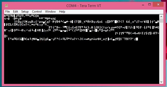

Hi Gunnar,
Appreciated your help thus far.
I have successfully powered up a hybrid kit board today (the logic board v1.3b).
You mentioned that there are 2 .exe in the disc. You are right.
However, other than the MotorGUI.exe, the other (AP32006i_Inverter_TC1767_v2.10.exe) is kind of a helpsheet/instructions. It does not seem to contain any .hex files. Please correct me if I'm wrong.
I have downloaded the Hightec Toolchain via the link you given me from way above.
https://www.infineon.com/cms/en/product/microcontroller/32-bit-tricore-microcontroller/audo-family/t... under Free TriCore Tools then Audo Family Free Tool Chain.
However, there seems to be some problem with it when I hit the 'debug' button. (Launch failed. Binary not found).
Thus, I am trying to establish connection with it serially via the ASC BSL.
Also, can you explain why you mentioned that you would prefer to use the JTAG over the serial communication for programming purposes?
What is the advantage of doing so?
Thank you!! (:
Thank you!! (:

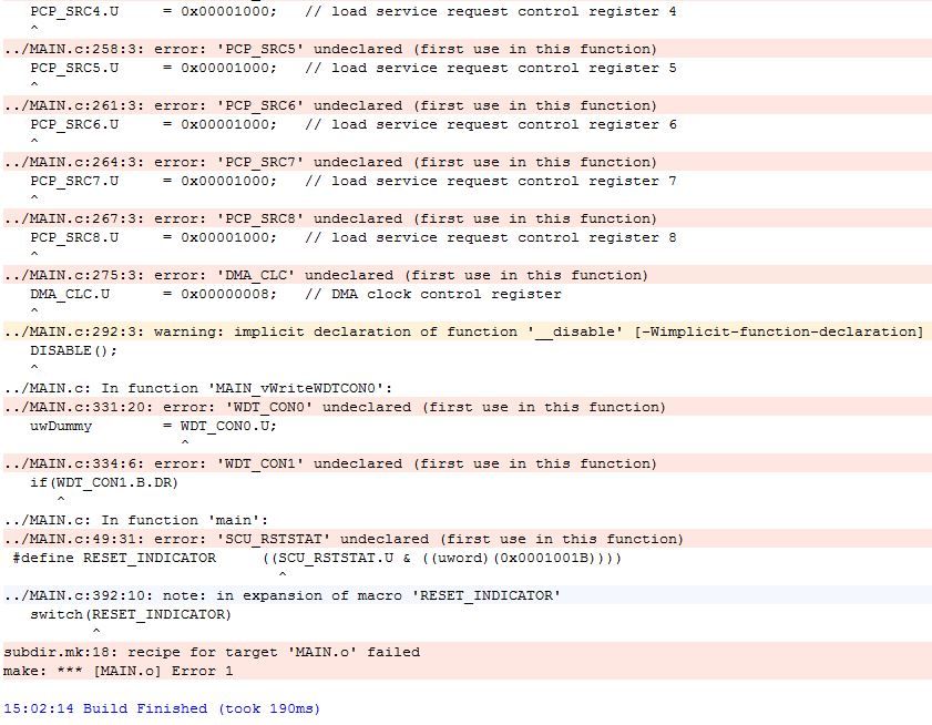

I did run the original AP32006i_Inverter_.exe and it did generate both documentation and code deep in some sub-folder(s). There are c++, files, .hex-file and one .elf-file.
If you do not have them I can send you an email with mine. Note: I might have a different version of Tricore 1767.
You need to build the Tricore-hex file first together with the .elf file. Have you tried that ? (Debug alone does nothing)...
Just try to import the Dave-Bench-Project generated from the Dave-Bench and compile/build it.

I am able to import the dav project into the Hightec-Eclipse-Studio and build the files by pressing ctrl+B.
However, I am not sure what this does, and I still couldn't debug it.

Seems like the generated .h files are missing, you have to import them manually if it is not done automatically.
The #include - reference could also be wrong, meaning they are in an unreferenced folder.
What is the first error in the list?

Hi Gunnar,
This is the most updated post.
1) There's no .elf and .hex file from the file you emailed to me. Not sure if I'm missing out on anything.
2) The errors persist. I have re-generated the codes from DaveBench and imported them to HighTech Eclipse Studio. The headers are in, but the error persists.
May I know what the next step is to get this thing working?
Ok thanks for the update this looks like a version conflict of Tricore lib in Hightec and generated stuff from Dave.
In worst case we would need an older version of Hightec not sure if support will be free.
Let me take a quick look at it

I found the .elf and .hex files.
I cannot establish any connection with Memtool.
The way I am doing serial connection is this:
Connect a USB/RS232 TTL 3.3V from the computer to the TX and RX pins on the board, as well as ground.
Provide 12V to the board, and ground the analog and digital ground together.
Then, I use TeraTerm to try to read from it.
From a file which you shared - https://www.infineon.com/dgdl/AP3213211_TriCore_AUDO_F_Bootloader.pdf?fileId=db3a30431d8a6b3c011d960..., I used RealTerm to try to send a null character to it, in hope of receiving 0xD5 according to page 4 of the document.
However, I have failed to receive anything.
Also, from another link which you shared - https://www.ehitex.de/zubehoer/2276/dap-miniwiggler, I am based in Silicon Valley, but this is in euro. I am wondering if the new version DAP MiniWiggler V3 with 20 pins have backwards compatibility and will be able to be used with HybridPACK 2?
The v1.3b only has a 16 pin JTAG pinout. However, my question is whether we can actually connect the new DAP MiniWiggler V3 manually with wires to the 16 pins.
This is because it is really hard to find the DAP MiniWiggler V2, which is already obsolete and not in production anymore.
Thank you for your expertise.
This is actually great news this means that the connection works and the Software is on the board (or at least part of it)
Just be sure that you are cross connected meaning that RX from your USB/RS232 TTL 3.3V is connected with TX on the Tricore Board and vica versa.
Also check the baudrate of your terminal-connection and the protocol
I did upload an example of terminal connection (see screenshot above).
If you restart the board and plug in again you should receive the Info text (again?).
If it is readable, you can communicate with the board through the Tera Terminal via shell (serial)
You could also try the MotorControl.exe gui (must install old Labwiew stuff with it)

Hi Gunnar,
I have emailed you the file from my infineon disc.
I am trying to resolve the error which I shown in the previous post currently. Please let me know if you find out anything or if it's a software backwards incompatibility issue.
Also, I am not sure what to do with the .hex and .elf file which you have sent me. Please guide me along.
The above is how I connected.
Digital and analog GND are grounded together and then connected to the GND of the converter. TX and RX are connected to RX and TX respectively. 12V is provided to the white wire. Black wire is ground.
I do not know anything about the MotorControl GUI so I have not try anything with it. Also, it seems like I would need a motor and external items for it to work so I guess I shall skip this for now.
I have tried the various dip-switches configurations but to no avail, such as 10101xx0 (ASC BSL) and 00000010 (booting from flash). It seems like 10101xx0 is the right one, however I receive nothing when in this configuration.
I only receive garbage characters when the dip-switches are in 00000010 (booting from flash).
Please don't do this. Don't spend your own money on this. I will just buy the one with the 16 pins. I couldn't find any datasheets for the DAP MiniWiggler V2 as infineon seemed to have removed it. I saw that thread as well regarding the incompatibility of the V3 with V2.
Once again, thanks so much for helping.
EDIT: Leave the dip-switches in the same position as original, do not change anything there
It looks right as far as I can see
This is the right one, as the program we want to communicate with should be in the flash, the "Garbage" is most likely the intro text which comes at the start of the shell.
(the other would be right if the chip was empty)
Have you compared your settings with the one I sent you in last post?
If the settings are right then the reason for garbage can be:
1) Wrong encoding (maybe not UTF-8)
2) Wrong speed (I assume you have the right baudrate 115000 i think)
In the device-manager whcih controls the USB/serial converter there is sometimes a speed ramp which can be adjusted both for RX and TX
You could start by setting medium speed for both (but keep the baudrate 115000)

I am able to receive garbage characters again.
Have tried your settings but still getting garbage.
How did you get such human readable information?

But back to our problem we have to make our garbage readable.
I need following info from you
1) Version of Windows your PC is running
2) Confirmation that your dip-switch is configured for Flash 00000010 do not change it.
3) Screenshot of your terminal with the crap preferabely.
You could try
1) Change the advanced settings of the USB/RS232 com-port in the devicemanager to lower speed, see previous post
2) Change the encoding settings in the Tera terminal settings from utf-8 to cp1252 or iso 8859-1 (latin1), see previous post
3) Type "help" in the terminal window and press "return" on the keyboard.

Hi Gunnar,
1) My windows is 8.1, Version 6.3.9600 Build 9600.
2) The configuration is 11111101 - booting from flash (not 00000010 sorry I read wrongly initially).
3)
1) Have tried speed at 9600 but still couldn't work.
2) The only other encoding in TeraTerm is UTF-8m for coding(receive). There is no selection for coding(transmit). Tried it as well.
I also have putty and realterm installed and can be used if you think they are helpful.
Will try this now.
I have no problem opening this. However, nothing is happening when I click on "Connect to Controller".
What do you mean by making it run?
Whatever works to load the code from the Flash, it seems to work as far I see it 🙂
The main function in the Flash starts with writing a long text and this seems to be it.
So this is OK
Change the speed bar (only for your connected USB/RS232-device) to 50%, in the Windows-device-manager see picture
(sometimes it is called oversampling and is also configurable in the terminal clients and is usually set to 16, check it too there and set it half,say 😎
Then switch power off and on again for "Garbage" collection...
Try another client (remember to close Tera Term first, only one client at once)
In the code -description they recommend Hyperterm.exe.
Preferabely use one which is default in ascii-encoding

My MotorControl.exe does only run with old Labview Stuff, would need yours if you can pass it to me...

Hi Gunnar,
Yes, the default settings are american local.
I have tried your suggestions, but I still collected garbage.
The help command does not generate anything.
I have emailed you the MotorControlGUI.
I cannot connect to the MotorControlGUI. It showed that the port is active as long I connect the USB to serial converter. It still shows 'active' even when I unplug the USB/serial converter from the logic board of the hybrid pack. Hence, I deduce that a connection has not been established between the board and the computer.
If there's anything else left to try, please let me know.

Thanks a lot. I did email you back an old tool named uspy which I am not sure that works now but worked well for me when I was debugging serial communication with XC878 years ago.
What happens if you unplug the USB/Serial converter and close the MotorControl Gui and open it again, does it then still show green? i.
If so then the GUI is ignoring the Shell-command of the controller.

Hi Gunnar,
USpy cannot detect anything at all.
It will not be able to choose the com port and not enter the main screen.
I have tried your suggestions but nothing worked.
Anyway, when we create a new project in the IDE, we were asked to select the core (TC1767) and then a board (EasyKit, TriBoard, etc).
Why is this so? Is the code generated specific to the board?
Also, please let me know when you have time to test out the code generation regarding the .hex/.elf files and whether there are any conclusions from there.
I seem to hit a wall and I have no more idea on how to move forward with this.
Ok this is indeed bad news. This means it does not work for the newer Windows versions as i feared.
It seems to work for Windows 7 according to user thread but unclear if for 64 bit version.
Edit: I saw that the new Dave Eclipse 4 (which supports the XMC -series based on ARM - Cortex) has a tool called XSpy, maybe that will work with newer Windows.
This tool can aslo be downloaded extra as it seems (not found it yet)
Yes sorry this was a stupid and wrong question on my half.
I really wanted to know what happened if you close the Motorcntrol-GUI , take the power off the controller-board
and open the Motorcontrol-GUI again if the serial connection light is still green even if controller bard is shut off
(But USB/RS232 still connected to board and PC)
Yes. In the perfect world we would have a similar option for the hybrid-kit board too. Or at least we could import it as a existing Dave Project as i hoped first.
Unfortunately we have only the generated code but at least specific for hightec and tasking in your code.
They have also precompiled for us 3 major configurations (serial parallel etc).
This means that we have fewer things to reconfigure hopefully if we would change something regarding configuration.
However if we would change configuration following steps would be necessary:
Open the 1767-dip file with Dave. Change the configuration in the visual editor and regenerate the code.
Then we have to manually transfer the changes to the Hybrid kit code and recompile it in Hightec Ide.
Note: This is still easier than learning correct register settings from the Tricore manual for the hundreds of possible configs.
And now the best part: To trick the new and only Hightec Evaluation Eclipse, which is only valid for 30 days for the legacy TC1767
we have to create a standard avalailable 1767 project, delete the generated files we are not using manually , then add our files and recompile all.
Not sure though that all which is used in the Hybrid Kit is supported in the Evaluation Version.

Managed to compile the generated files from our Dave-Bench test to .elf (hex-file)with the new evaluation Hightec-Eclipse-Studi- Ide from your link.
I had though to add extra 1767 files to make it work as they were missing in the Tricore Toolchain include (surprisingly the library had the object files needed).
The existing examples for 1767 board (no standalone 1767 project available) can be compiled to hex .elf (hexfile) only because they include precompiled existing objects.
There seems not to be full support for legacy TriCore-Versions (176x family) in the High-Tec Tricore Toolchain which is at http://free-entry-toolchain.hightec-rt.com/.
However it can be used for one year for free, but full functionality is only for new Tricore 2x-family and no extra support.
Strangely at the other link which I used first (https://www.hightec-rt.com/en/support/license/evaluation.html) I did only get an automated email (not code for download).
However I was offered a version with full functionality and full support but for only 30 days. I would really prefer that, I have to wait until Monday most likely until sales-team sends me the download version.
Edit: The only difference is that these are two steps;
(using the evaluation product key i got in the first step, retyping email etc, and adding extra info like MAC-adress)
https://www.hightec-rt.com/en/suppor...ctivation.html
On the first sight this package looks exactly like downloaded in the previous link, with limited support for one year.
Edit: I replied with an extra request to the email i received on Sunday and got today an answer with a 30 day evaluation version from Hightec (which should include full support)
Will test it out, really exited about this.
