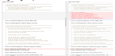

and i assigned port like below picture(tx:P20.8 , rx:P20.7)
i understand as when i assign CAN port properly, but it doesn't works.

thank you for replying.
i have a question about pin assginment.
when i assign CAN tx/rx pin by using pinmapper tool, there was already existing pin settings. like below picture.
(P15.1 / P15.0)
it defines CAN Module 0 / Node2, so i didnt' delete above assignment.
and i add CAN Module0 / Node 0's assignment by using pinmapper tool. and below code is generated automatically.
after generating above code, i didnt' made CAN module configuration, and just modify existing code from (MODULE0/NODE2) 's RXSEL value to MODULE0/NODE0's value.
in this condition, TX/RX function is not working properly. after deleting MODULE0, NODE2's pin assignment from code, it is working normally.

1) pin mapper is an auxiliary tool, and eventually you need to review the configuration of all pins, because the settings in the final C language file are written to registers
2) First, you could make CAN0 NODE0 working, then you can configure CAN0 NODE2 working, These 2 NODES require 4 pins to configure, and each node requires an RX and TX. In my example above, you can see one node configuration. You can refer to it to configure second node.
