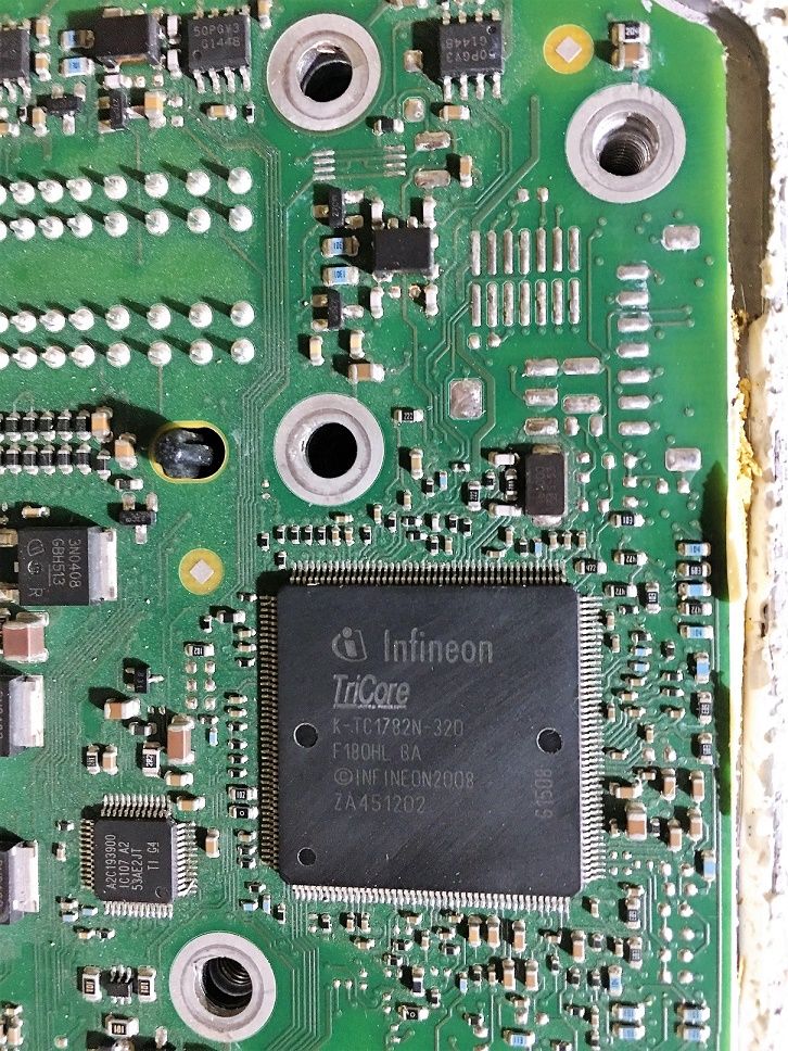

Hello There,
My purpose of this thread here, is to humbly ask about Reading/writing FLASH and EEPROM of Infineon Tricore 1782.
I want to read it's complete memory and copies it to another MCU.
In my case this MCU is installed on Honda Vezel's 2015-16, Transmission Control Module made by Continental, but unfortunately no programmer in my knowledge supports this specific TCM's reading through OBD or no pinout could be found by me so far..
So I have to read it on board.
Kindly guide me. How can I be able to read this MCU on-board?
I am also attaching its Photos.

Reading the EEPROM is a matter of placing it in a suitable device programmer, it is just a serial EEPROM.
Reading the FLASH is a different matter entirely, if the manufacturer did not disable reading of flash it may be possible to do it using a modified CANLoader via the CAN BOOT mode.
See application note #32136
Good luck finding the code listed in chapter 7.
