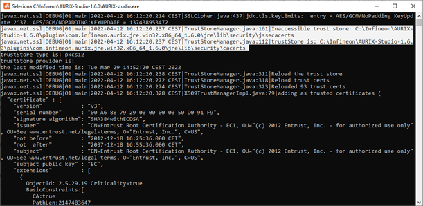

    1. Overwrite the AURIX-Studio.ini in your ADS installation directory with the one attached to this reply (backup the old one, and unzip the new one)
    2. Launch ADS. A console should also open. Select a workspace and let ADS complete loading.
    3. Once ADS complete loads, scroll the console to the top, you should see a text similar to the following: enrico_b_0-1649773669033.png
    4. Search for the text "trustStore is:" and paste it here please. It should be a cacert file contained in the installation directory of ADS, like in the screenshot above. It should not rely somewhere else.

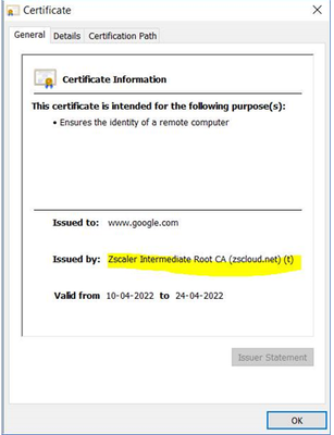

  • Another cause could be the presence of a proxy server configured to perform SSL interception (or SSL bumping), where the proxy server replaces the SSL certificates with its own. If this is the case, the TrustStore may not contain the Certification Authority (CA) that released the certificate used by the proxy server, and all connections with our remote servers would be prevented. To check if this is the case, do the following (instructions for Microsoft Edge):
    1. Open https://www.google.com
    3. Click on the rift item of the list (it should be "the connection is safe", or something similar)enrico_b_2-1649774905410.png
    5. You will get the information about the certificate in use. It should be released to "www.google.com", and the Certification Authority should be GTS CA 1C3. The screenshot below displays the information I am talking about (sorry the interface in italian). If you see other information, the certificate has been replaced by the proxy, and ADS cannot recognize it. If this is the case, please let me know, and I will try to find an alternative solution.Annotation 2022-04-12 165125.png

  • The Java Virtual Machine used to run ADS is using a wrong Trust Store, which is the "container"  of all certification authorities known by the Virtual Machine, which are used to establish encrypted connections. This doesn't look your case, from the configuration you sent me, you are correctly using the right TrustStore. To be 100% sure, you can perform the following steps:

I tried the second option and finds following setting, the certificate is not matching. Please find the below snapshot.
HI, is there any updates on this ?
you have to add the certificate generated by "your" intermediate CA (Zscaler) to the trust store of AURIX Development Studio.

Procedure:
  1. Save the certificate on a file. From the "Certificate" window you posted on the previous message, click on the tab "Details", then you should see a button to export the certificate to a file. Click on that button and select "DER X.509 (.CER)" as a format. Save on any file
  2. extract the zip file attached to this message anywhere on the system, and move to that folder a cmd.exe terminal.
  3. Launch the following program:
    keytool -import -v -trustcacerts -file <position of *.cer certificate file> -alias zscaler -keystore <ADS Installation>/plugins/com.infineon.aurix.jre.win32.x86_64_<ADS version>/jre/lib/security/cacerts -storepass changeit
At the end of the procedure ADS should recognize your intermediate CA.
Let me know how it goes.
