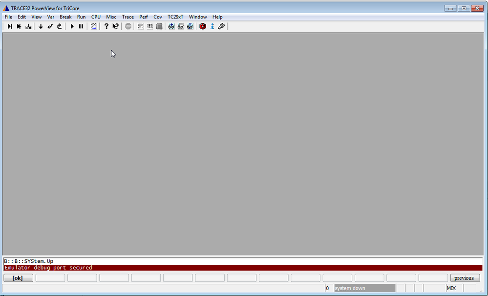

I'm trying to load .cmm file through TRACE32. When ever i tried, it showing "Emulator Debug Port Secure" error. Can any one tell me,
what could be the reason and how to solve this issue? Please find attached the screen shot for the same. Thanks in advance.

Are you using the Trace on a brand new controller without software or bootloader?

Yes. I am flashing software in new controller(first time flashing in to TC275 controller). Could you please tell what could be the reason.

I had a similar problem von TC277, you don't have a bootloader so that there is no function able the Trace. The JTAG is a seperate module which isn't able to communicate with the rest of the uC.
My solution was to use the bootstrap loader, which exists on every device hardcoded for a first connection.
You have to use pins 14.0 and 14.1 either for ASC (UART) or CAN connection to flash a bootloader.
Infineon offers an application note with example software to flash by bootstrap (AP32272).

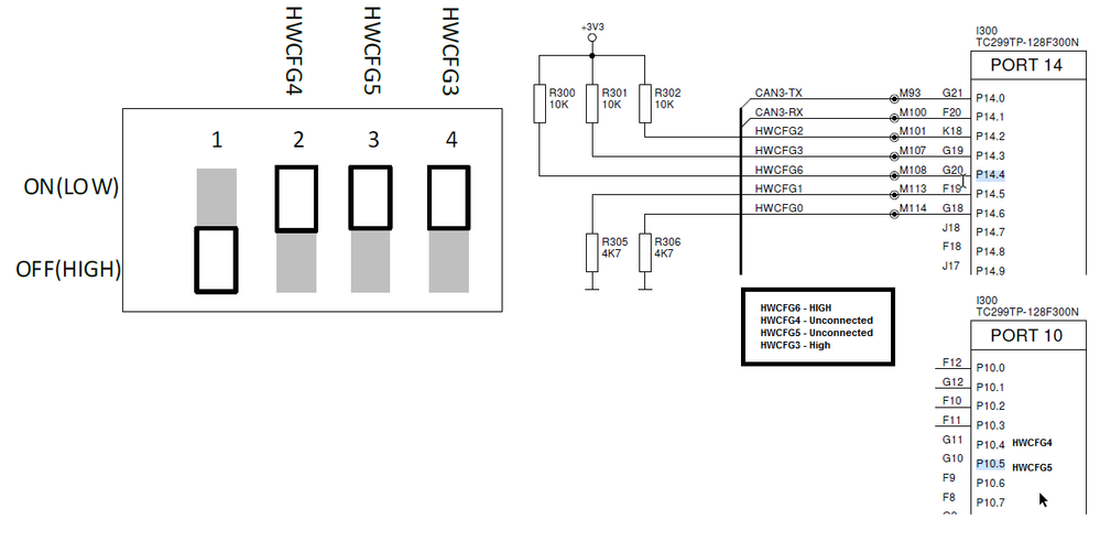

How do you control HWCFG3? By DIP switch or the onboard pull-up? HWCFG3 need to be LOW to use HWCFG4 & HWCFG5 for booting.
Can you then change DIP switch of HWCFG4 & HWCFG5 to OFF(HIGH) & reset the target board.

what is the State of HWCFG4 and HWCFG5 in your schematic?
Mar 17, 2020
09:21 PM
Mar 17, 2020
09:21 PM
Hi
I am using the IFX starterkit.
Both HWCFG4/5 are HIGH.
On your schematic, if u pulled HWCFG3 to LOW & with HWCFG6 pulled HIGH, HWCFG4/5 will be HIGH.
