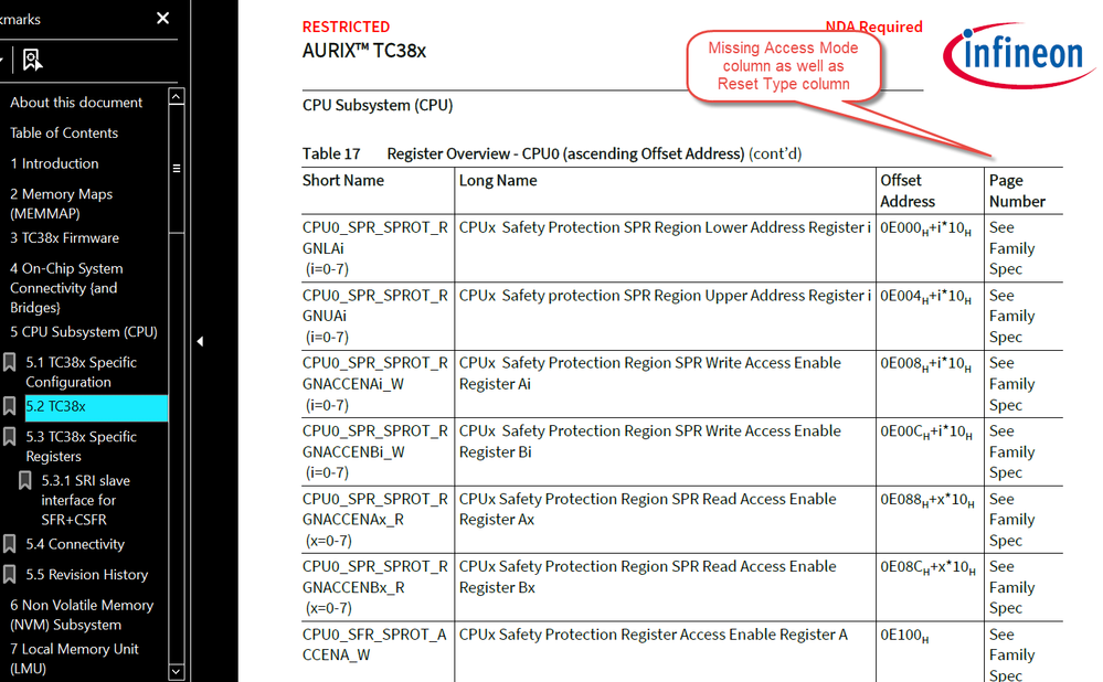

Hello Support,
For Aurix 1G User Manual, I could find the CPU Subsystem Register Table containing "Access Mode" and "Reset Type" columns as shown below.
Can you please tell me which document for Aurix 2G contains similar CPU Sussystem Register Table showing "Access Mode" and "Reset Type" info?
The best I could find is shown below for Aurix 2g Deice Specific User Manual which doesn't contain the above mentioned columns.
Best Regards

Please see the Family spec. AURIXTC3XX UM part1 V1.4 Table 109 in chapter 5.3.4.22.2 Summary of SFR Reset Values and Access modes.
