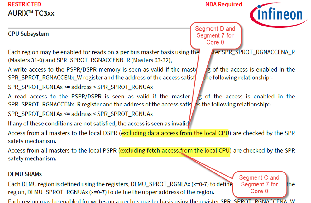

Shown below is a snippet from Aurix 2G User Manual about Bus MPU Safety Protection.
Does this mean the following?
1> For Core 0, Segment C and Segment 7 are never checked for Bus MPU related to PMI/PSPR Fetch
Similarly for Core 0, Segment D and Segment 7 are never checked for Bus MPU related to DMI/DSPR Data access.
Is that correct?
Or, it is not checked for Segment C and D respectively?
Which one?
Is it only for Local Addressing [Segment C/D] or also for Global Addressing [Segment 7 for Core 0, Segment 6 for Core 1, Segment 5 for Core 2]?
Please elaborate with some example ranges so that I can better understand.

Bus MPU Safety Protection only lets a CPU restrict access to its own DSPR and PSPR memories from reads over the SRI bus.
For a CPU accessing its own DSPR and PSPR, it can only restrict data reads from PSPR (not instructions), or restrict instruction reads from DSPR (not data). Both global and local addressing apply.
Figure 51 PMI Block Diagram shows that the CPU has a direct path from the CPU fetch pipeline into its own PSPR. That direct path means that the Bus MPU does not apply.
Figure 52 DMI block diagram show that the CPU has a direct path from the CPU memory pipeline into its own DSPR. That direct path means that the Bus MPU does not apply.
