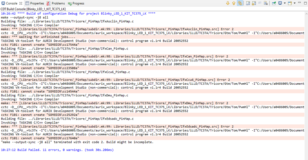

I am evaluating the TC375 and am trying to build the blinky example, Blinky_LED_1_KIT_TC375_LK, and am getting build errrors saying it cannot create SOMEDIR.
I searched the entire project and its configuration files and could not find the instruction to create a SOMEDIR\ directory. How can I resolve this issue?
I have attached the log file.
-Shantanu

For additional information,
Here is the screenshot of the console. The project settings are unchanged from the stock blinky project. No project, including blank Aurix projects are building and they all have the same issue:

Hello Shantanu,
this error usually comes out because of missing space or missing rights.
Where did you install AURIX Development Studio? in which folder?

It seems the compiler is not able to create temporary files.
Can you please see which TEMP and TMP folders are configured in your system?
Check the folders returned by command 2 and 3 are existing and writable by your user.
Kind regards
- Open Windows Commands Prompt (Windows Key+R -> run)
- Execute command
echo %TEMP%
- Execute command
echo %TMP%
