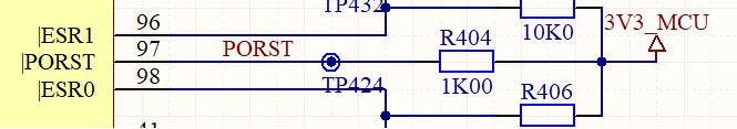

I was using Infineon TC334 light kit with UDE PLS debugger, everything works fine and I build my application draft.
Now I received our custom board using TC324, but I can not establish JTAG/DAP connection with the board, here are some information about it:
ESR0: aways low.
PORST: switch LOW / HIGH while debugger tries to connect.
ESR1: aways high.
VDD: 1.25v
VEXT: 3.3v
VEVRSB: 3.3v
actual configuration: 1 and 2 set via pull down to 0. rest is a 1 via internal pull up
Any hints or ideas I could try?

Can you also check if all the guidelines in AP32438 are followed?

Hello User15256,
Could you share the schematic portion showing the connections to HWCFG4 and HWCFG5 as well ?
Thank you
