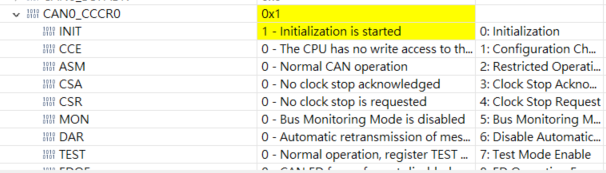

Hello Support,
I'm using TriBoard TC397 V2.0 and MC-ISAR_AS422_TC3xx_BASIC_1.40.0
Follow the demo code for MCMCAN module, I write the code blew.

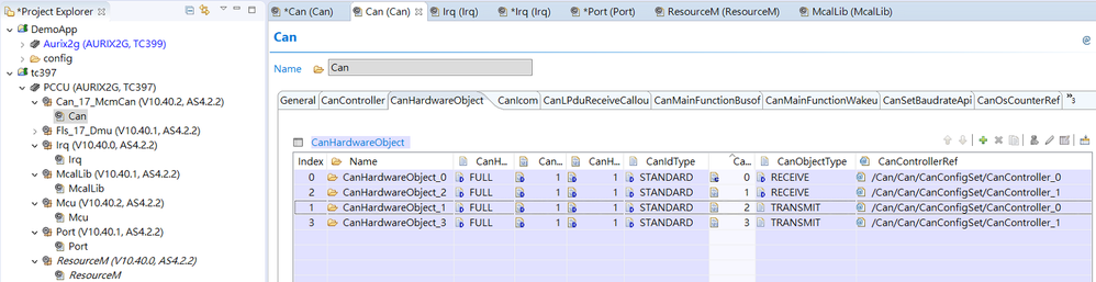

Here is my EB tresos config

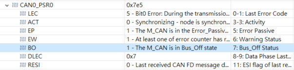

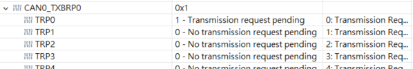

Initial OK, but when run after Can_17_McmCan_Write -> Can_17_McmCan_lWriteMsgObj
code line 5840
It will occur bus off error, and then into bus off ISR
I cannot see any message in busmaster
And in next while loop it will always stuck at bus off.
It should be no problem after Can_write function execute,right?
Please give me some suggestion to solve this problem, thank you.
