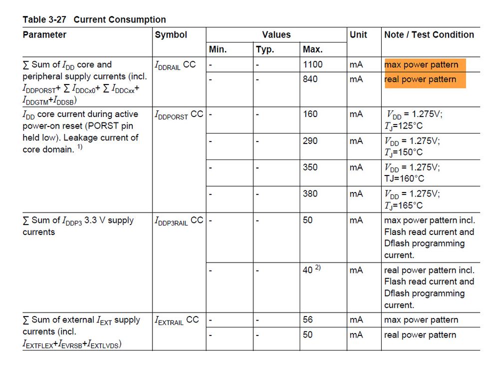

Hello Support,
What does "max. power pattern" and "real power pattern" means within Aurix 2G Datasheet as shown below for TC38x device?

Please see PWR_TC.P014 in the latest errata sheet of TC38x for max power pattern description.

See the definitions in 3.12 Power Supply Current.

Hello Support,
"real power pattern" is now well understood from the definition.
But where is the definition of "max. power pattern" in section 3.12 of datasheet?

3.12 describes real power pattern, max power pattern, and ADAS power pattern.

Hello Support,
TC38x Datasheet doesn't define "max power pattern".
TC39x Datasheet does define all the terminology.
