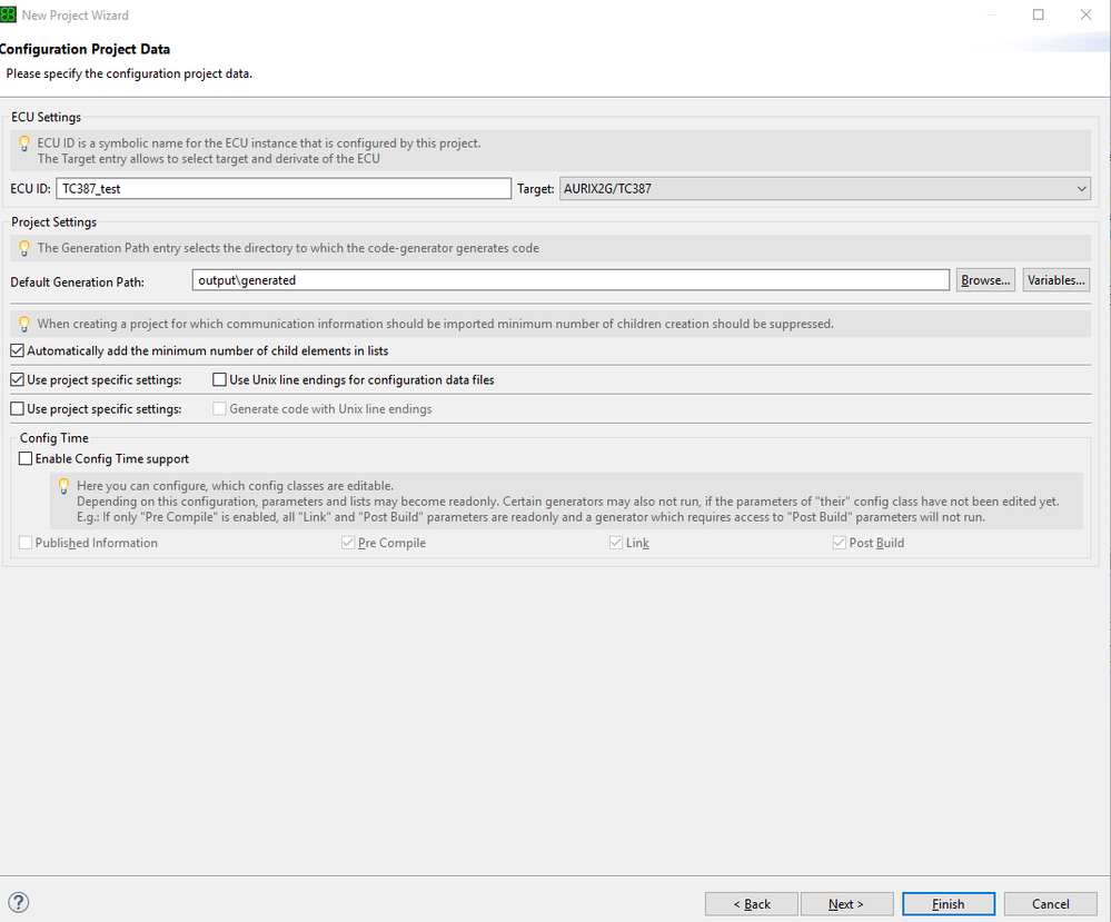

Can you show the project configuration? It seems like yours might be missing the ResourceM module. Here's what mine looks like:
If you're creating a brand new project, people often miss the most critical step: under Configuration Project Data, you have to make sure this box is checked:
Automatically add the minimum number of child elements in lists

I assure you. I added the ResourceM module and had already checked the Automatically add the minimum number of child elements in lists
but the error is still consistent.
I also noticed we have different versions.
Below are the configuration of a new "configuration project" with steps till the error.

Yes, we have very different versions. Mine is the latest 1.40.0 RC. Yours appears to be something just before 1.10.0. Can you try the latest?
