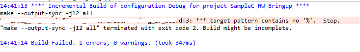

Hi all,
I have problem with aurix development studio.
I created a new project with aurix develoment studio, build and run oke.
After that, I change project location and import the project into aurix developoment studio again.
I can clean up and re build all the project without error.
Problem is when I build without clean up, I get error like below:
Please help me with this issue

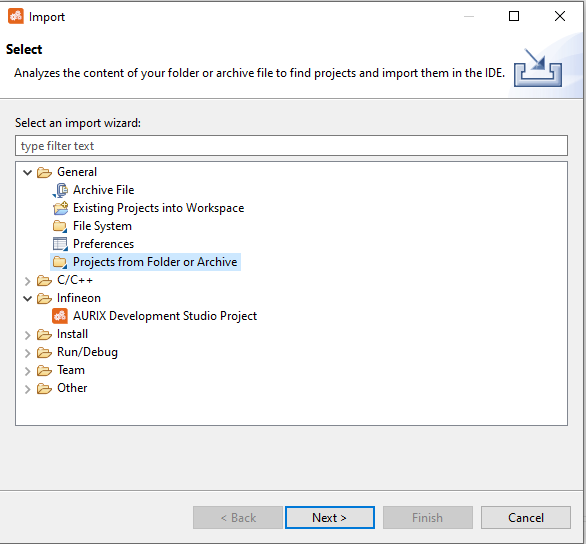

Dear teoBits,
I choose File > Import. In General, choose Projects from Folder or Archive.
After that, choose project folder

Usually that error pops up when the imported project is not copied inside the workspace. I never used the Import "projects from folder or archive", so I do not know what really happens using it.
Anyway, to import a project you could also use the Import "Existing Projects into Workspace" and select the option "copy projects into workspace", or even better you can use the dedicated import function "Infineon">"AURIX Development Studio Project" and select "Local code example repository" and browse to the folder where you have the project stored.

Thank you very much for your respond
I follow your guide. The first one worked well.
But the second did not work.
When I browse to project folder, no project has found
