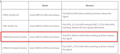

Hi Owen,
Sorry I should’ve said - I performed the reset and recover steps as specified. I grounded both the XRES and SPI2_MOSI pins, and then released the SPI2_MOSI pin, followed by XRES.
My UART->USB does not have cts and rts pins unfortunately, so I cannot do this with my current hardware.
Owen_Zhang123
500 solutions authored 250 sign-ins 1000 replies posted
The flow control of HCI UART must be enabled. It is hardware controlled.
Please find a USB to UART tool with CTS and RTS. Then try to program the device again.
