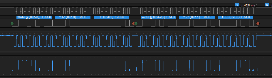

I am using STM32F303x microcontroller to established the communication with the TLE493D-W2B6 A0. I made the reset commands as said in the manual (Star...
Show More
I made the reset commands as said in the manual (Start -> 0xFF -> Stop -> Start -> 0xFF -> Stop -> Start -> 0x00 -> Stop -> Start -> 0x00 -> Stop), and tried configuring the registers 0x10, 0x11 and 0x13.
I received acknowledgement from the sensor, thus confirming the correct usage of address. Also, I was able to turn ON/OFF the INT mode of the sensor, by changing the bits in 0x11 (MOD1) register.
Having said that, I was not able to read any register values and even if I read, it is giving me plain 0xFF (255) and nothing else. For example, once I configured the registers, I requested for 20 bytes (0x16 is the last register). I got 0xFF in response (20 times). This included the registers that I configured with different values. Each time I receive with an ACK from the sensor, confirming the communication being established.
I tried a working code (arduino) for the magnetic sensor with an Arduino Micro, and the result was same. The sensor that I used with arduino and STM32 are different but the results are quiet the same. I wasn't even able to read out the value from version register.
I even looked into your official GitHub library - https://github.com/Infineon/TLE493D-3DMagnetic-Sensor - where users commented about similar issue (reading 0xFF).
The configuration values that I used for each register are as follows (STM32)
0x10 - CONFIG - 0x10 (no trigger bits), 0x01 (parity bit set).
0x11 - MOD1 - 0x11 (no trigger bits), 0x85 ( Two Byte Master Mode with Clock stretching enabled and INT disabled and parity bit set).
0x13 - MOD2 - 0x13 ( no trigger bits), 0x40 (update rate of 24Hz).
I would like to add that I have tried other configuration settings -
- With and Without Parity bits (Config and MOD1)
- 2-byte and 1-byte mode
- Low power mode and Master mode
- INT enabled and disabled
- Different update rate
I will be glad to provide more information, if required. Thank you. Show Less

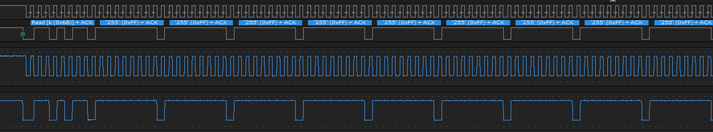

I am using (or attempting to use) a teensy 3.2 using the Arduino IDE to interact with a 3-axis hall effects sensor (the Infineon TLE493D-A2B6). The se...
Show More
I am using (or attempting to use) a teensy 3.2 using the Arduino IDE to interact with a 3-axis hall effects sensor (the Infineon TLE493D-A2B6). The sensor can only be interacted with via I2C, and it has 2 addresses. The first address (6A Hex) is the write address. 6B Hex is the read address. As an initial test, I am trying to write some configuration data, and then read back some sensor data (initially just 1 register worth of data, essentially the MSB for the x-axis). Here is my Arduino code:
// Define includes
#include // Wire header file for I2C and 2 wire
int HallAddressWrite = 0x6A; // Device write address
int HallAddressRead = 0x6B; // Device write address
byte X_Axis_MSB = 0x00; // Bx MSB register
byte Y_Axis_MSB = 0x01; // By MSB register
byte Z_Axis_MSB = 0x02; // Bz MSB register
byte xy_Axis_LSB = 0x04; // Bx, By LSB register
byte z_Axis_LSB = 0x05; // Bz, By LSB register
byte config_Address = 0x10; //config register
byte value=0; //init value
int baudRate = 9600;
The above section is initialisation stuff. Hardcoding register addresses etc.
void setup() {
Serial.begin(baudRate); // Set Serial Port speed
delay(1000);
Wire.begin(); // Join the I2C bus as a master
Wire.beginTransmission(HallAddressWrite); // Address the sensor for writing
Wire.write(config_Address); // Address the Configuration register
Wire.write(0); // write the value to register
Wire.endTransmission(); // Stop transmitting
delay(100);
The above section is writing 00000000b register 10H
void loop() {
Wire.beginTransmission(HallAddressRead); // Address the sensor for Reading
Wire.write(X_Axis_MSB); // Write pointer register
Wire.requestFrom(HallAddressRead, 1); // 1 byte from sensor.
value = Wire.read(); // Read byte from register 12
Serial.println(value);
delay (500);
I find that value always equals 255 (11111111b).
Has anyone got any idea how I should be interacting with this device, or can provide some advice? Show Less

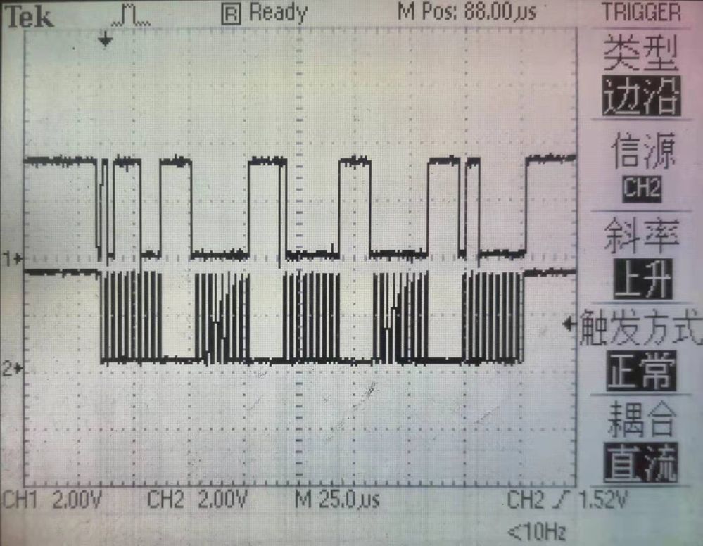

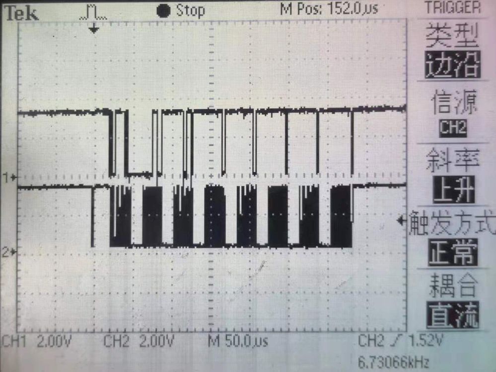

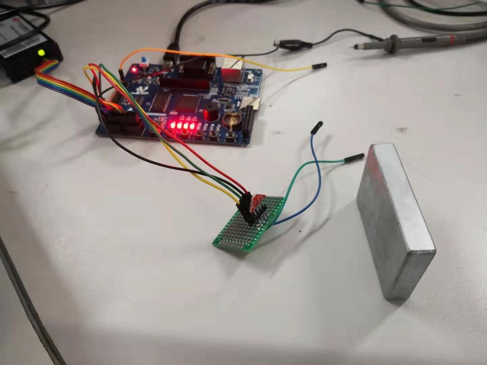

I read data from tlv493 via i2c bus with xilinx fpga spartan6. the setting procedure is:for low power mode:1. write data (0x00 0x80 0x00 0x60) to addr...
Show More
for low power mode:
1. write data (0x00 0x80 0x00 0x60) to address 0xBC;
2. write data (0x00 0x85 0x00 0x60) to address 0xBC;
for fast mode:
2. write data (0x00 0x86 0x00 0x60) to address 0xBC;
After mode set, int is produced according power mode, it works well, then I read data follow INT signal after 12us.
For the data read from sensor, Bx is right all the time,but By and Bz and Temp is wrong sometimes,when it is wrong, the register 2 to 6 are 0xff.
The other question is that in low power mode FRAM COUNTER is not increment all the time, It even depends on magnetic field intensity, sometimes normal, sometimes abnormal.
I am totally confused!
test picture
Write to sensor with 4 bytes
Read from sensor with 7 bytes
Read detals
